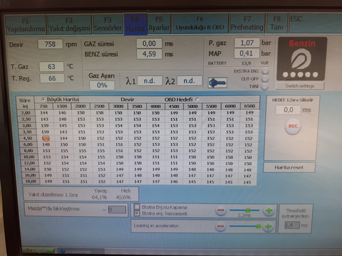

  • https://store.donanimhaber.com/79/75/05/7975053289aa6b3eddc32d0fe24cd92b.jpg
    Renault 1.2 16v 75 HP LPG UYUMSUZ MU ?
    Degerler bu sekilde rolanti.
