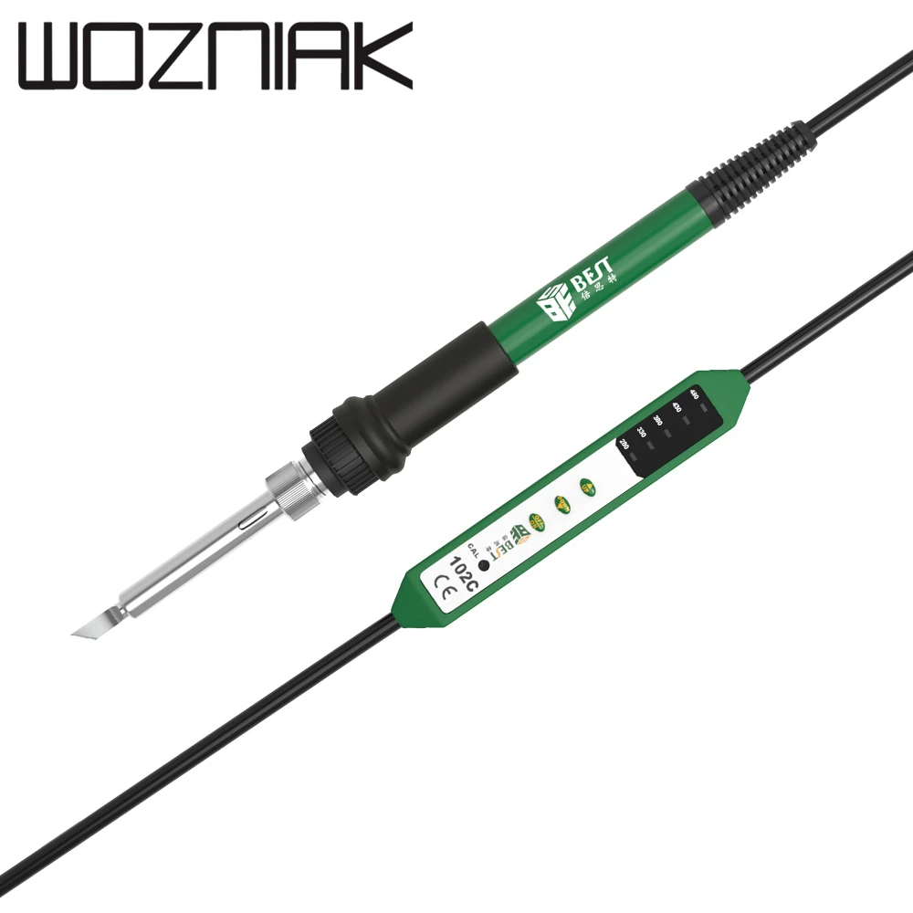

  • Havya olarak;
    aliexpress.com
    US $13.8 |BST 102C Adjustable Soldering Iro Electrical Soldering Iron SMD Welding Rework Tool Adjustable Temperature Solder-in Hand Tool Sets from Tools on Aliexpress.com | Alibaba Group
    https://s.click.aliexpress.com/e/ct1fqSku
    Pasta olarak lötfett, lehim teli stannol, weller. Proskit markalarıda iyidir bazı ürünlerini kullanıyorum kaliteli.
