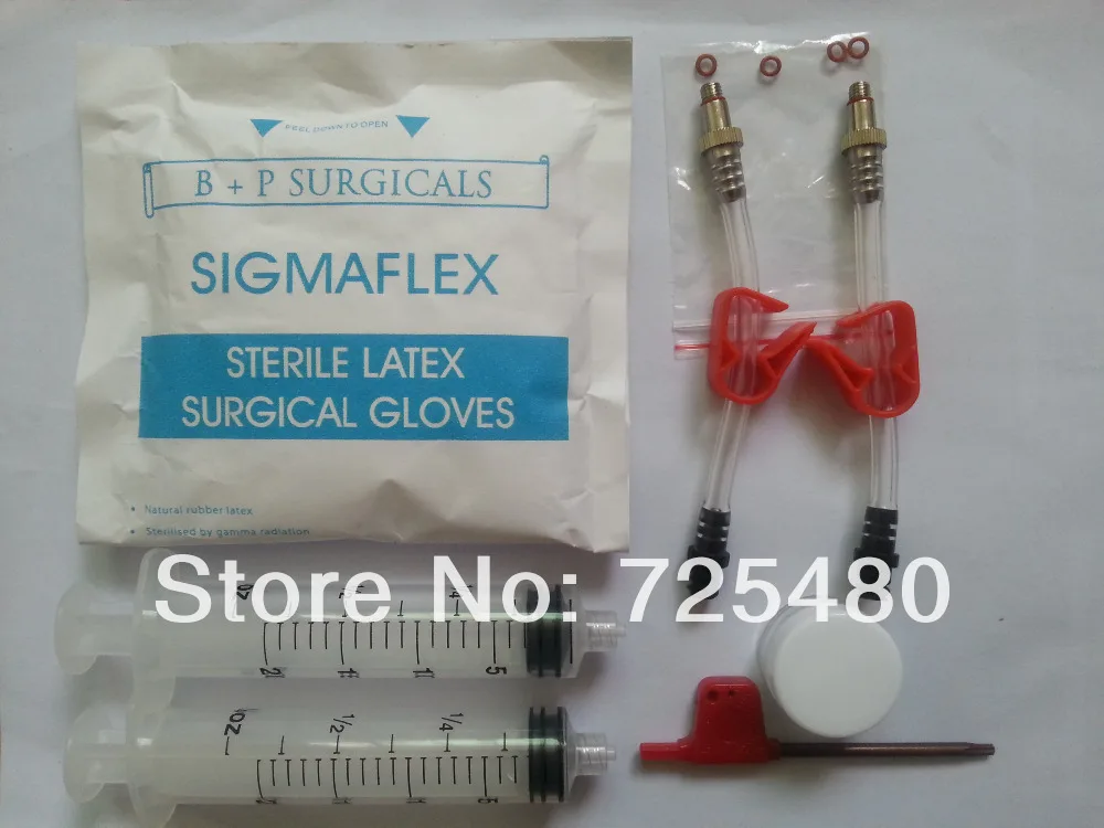

  • Bir tane bleed kit alacaksın. Sonra videodaki gibi sistemdeki havayı boşaltacaksın.
    aliexpress.com
    US $13.48 |Hot sale!!!Bleed Kit For Avid Disc Brake Juicy 1 3 5 7 9 Elixir Code RX R CR XO XX WORLDCUP CARBON TRAIL|sales kit sample|kit generatorkit dewalt - AliExpress
    http://www.aliexpress.com/item/Hot-sale-Bleed-Kit-For-Avid-Disc-Brake-Juicy-1-3-5-7-9-Elixir-Code/1827831761.html
