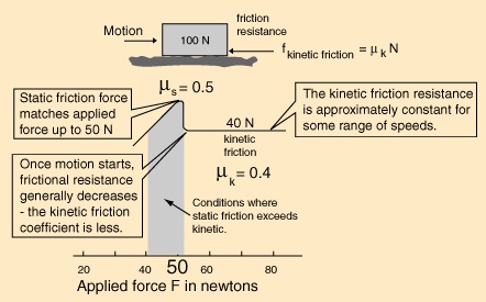

    ilk önce hava sürtünmesi ile yerin sürtünmesi birbirinden tamemen ayrı konulardır. Sizin ilgilendiğiniz bir aracın ilk hareketi için gereken kuvvet yani bunun için newton cinsinden ne kadar gerekliliği gibi konulardır. Ancak bir tekerin bastığı yüzeyde bir sürünme yoksa hareket mümkün olmayacak teker boşta patinaja kalacaktır. Konunun detayları aşagıda ;
    Static Friction
    Static frictional forces from the interlocking of the irregularities of two surfaces will increase to prevent any relative motion up until some limit where motion occurs. It is that threshold of motion which is characterized by the coefficient of static friction. The coefficient of static friction is typically larger than the coefficient of kinetic friction.
    In making a distinction between static and kinetic coefficients of friction, we are dealing with an aspect of "real world" common experience with a phenomenon which cannot be simply characterized. The difference between static and kinetic coefficients obtained in simple experiments like wooden blocks sliding on wooden inclines roughly follows the model depicted in the friction plot from which the illustration above is taken. This difference may arise from irregularities, surface contaminants, etc. which defy precise description. When such experiments are carried out with smooth metal blocks which are carefully cleaned, the difference between static and kinetic coefficients tends to disappear. When coefficients of friction are quoted for specific surface combinations are quoted, it is the kinetic coefficient which is generally quoted since it is the more reliable number.

  • Kinetic Friction
    When two surfaces are moving with respect to one another, the frictional resistance is almost constant over a wide range of low speeds, and in the standard model of friction the frictional force is described by the relationship below. The coefficient is typically less than the coefficient of static friction, reflecting the common experience that it is easier to keep something in motion across a horizontal surface than to start it in motion from rest.

  • Anlaşıldı, aracın hareketi için eksternal bir kuvvet gerekiyor. Ayrıca kütük ve metal kullanarak verdiği sürtünme farkından bahseden örnek de açıklayıcı oldu. Teşekkürler.
