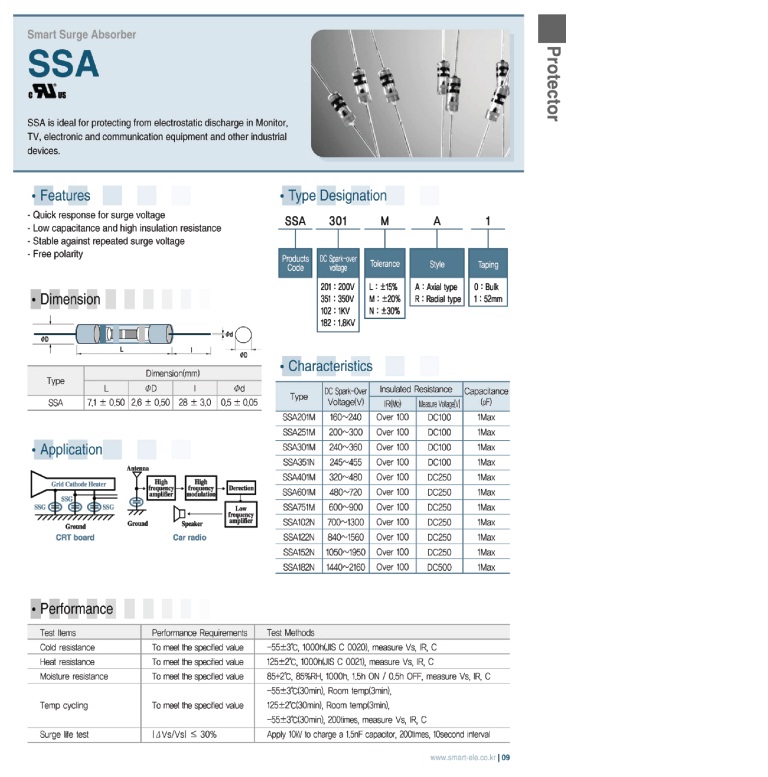

  • Selamlar.
    Sanırım verdiğimiz linkler dikkatlice incelenemedi...
    http://www.ec21.com/product-details/Surge-Absorber--3188597.html
    Bu linte :
    Description
    Surge Absorber is the latest released component for lightning proof protection, over-current protection, and over-voltage protection. It combines advantages of Gas Discharge Tube (GDT)’s bearing great surge current as well as of Semiconductor surge protector’s high speed response. Especially conquered the disadvantage of GDT’s slow speed response as well as Semiconductor surge protector’s anti-high-voltage and weak ability to over-current.
    TSC41-301M are kinds of micro surge absorbers specialized in lightning proof protection to communication equipment, with the advantage as follows: high speed to response, bearing surge current, stable capability, excellent repeatability, and long life. It is suitable for instantaneous over-voltage protection to ADSL, ISDN, MODEM, FAX, TEL, and for static protection to CRT display, TV set, etc.
    Feature:
    1. Strong capacity with bearing huge surge current.
    2. With small capacitance: (< 1PF 1 kHz), excellence of high-speed response.
    3. With excellent insulation resistance and no polarity.
    4. DC spark-voltage more than 5000V.
    5. With the small size, and long pulse life.
    Application:
    1. For static protection to CRT, Monitor, Color TV.
    2. For static protection to Audio frequency in car, wireless communication equipment.
    3. For instantaneous over-voltage protection to ADSL、ISDN、MODEM、FAX、TEL.
    4. For instantaneous over-voltage protection to CATV.
    5. For instantaneous over-voltage protection to RS485 & RS232 port.
    6. For instantaneous over-voltage protection to ammeter, water meter auto admin system, etc."
    yazmakta ki , burası bahse konu olan malzemeyi yeterince tanımlamaktadır.
    Ayrıca :
    http://www.smart-ele.co.kr/pdf/tsa.pdf
    http://www.smart-ele.co.kr/pdf/ssa.pdf
    Bu 2 link de , o malzemenin data - sheet leridir ( kkz. 2 adet resim ! )
    Kısacası :
    --- Bu malzemenin adı SURGE ABSORBER olarak geçmektedir. Yani kabaca bir tercüme ile , DALGALANMA ( YÜKSELME ) BASTIRICISI ( EMİCİSİ )olarak tanımlanabilir.
    --- Normalde resimlerde de görüleceği üzere , yalıtım durumunda 100 Mega Ohm gibi bir direnç göstermektedir.
    --- Kullanım şekilleri de yine resimlerde görülmektedir.
    --- belirlenmiş voltajına ulaşana kadar yalıtkan sayılabilmesine rağmen , bu voltaj aşıldığında , çok kısa süreler için AMPER ler akıtabilen bir malzemedir.
    --- Max. 1pF kapasitesi olduğundan sıradan bir kapasitemetre ile ölçülmesi de zordur.
    --- Yalıtkan gibi bir malzeme olduğundan , biryerlere birtakım akımlar akımlar geçirmesi beklenemez ve bir devreden tamamen çıkarılsalar da o devrenin çalışmasına engel olmazlar. Ancak voltaj dalgalanmalında veya yükselmelerinde devrenin harab olmasını engellemektedir.
    --- Resimlerde ve yukarıdaki alıntıda zaten kullanım alanlarını da görebiliriz.
    Şayet anlaşılmayan birşey kaldı ise , biraz daha araştırma yapabiliriz.
    Saygılar.
