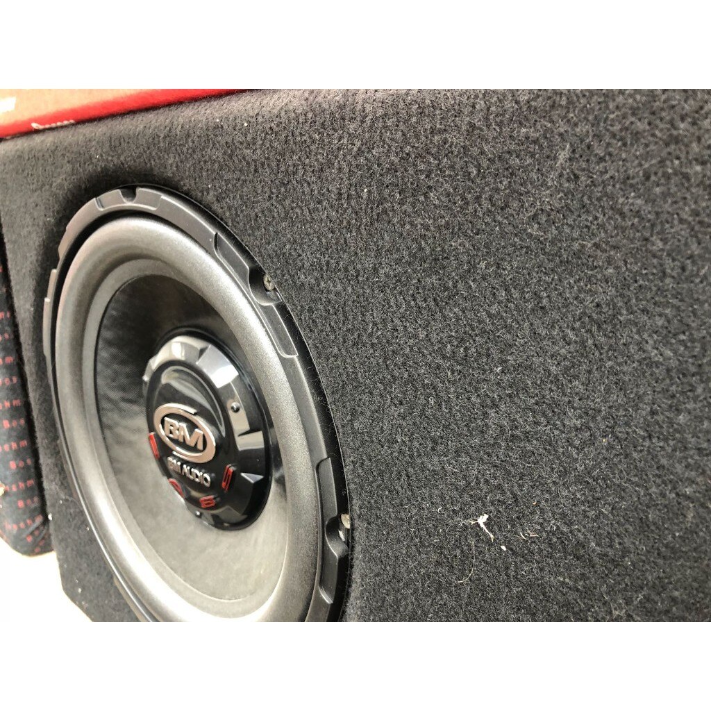

    Bass:
    m.n11.com
    Bm Audio Boschmann V-1266xrf Subwofer 900 Watt 300rms Çift Bobin - n11.com
    https://m.n11.com/bm-audio-boschmann-v-1266xrf-subwofer-900-watt-300rms-cift-bobin-P319357598
