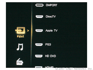

    Editör'lerin yazdığı kadarıyla GUİ oldukça yararlı bir yetenek kullanıcıları için. AV Reciever'ın hangi girişine neyi bağladığını hatırlamana gerek kalmadan, display üzerinden görerek yapabiliyorsun görüntü ve ses kaynakları arasındaki geçişleri.
    AV Receiver'ın kullanımını oldukça kolaylaştırdığını yazıyorlar.
    Sony STR-DA 5300ES'in GUİ'sine ait fotoğraf ve Cnet editör'ünün konu hakkındaki yorumu;
    "Like its predecessor, the STR-DA5300ES features a slick, icon-based graphical user interface. While certain Denon receivers will feature a GUI later this year, the vast majority of AV receivers with onscreen displays still use white, blocky text that looks dated in the high-def era. Press the Menu button and up pops the GUI, which gamers will recognize as similar to the Cross Media Bar ("XMB") navigation found on the PSP and PS3 interfaces. The first option is Input, which allows you to select an input visually, by name and icon, and change which video and audio sources are assigned to each input. You can also change the icon next to the inputs, so it matches the source you have connected, and rename the inputs themselves.
    The most enticing aspect of the GUI is that it makes using the receiver a lot easier, because it allows you to interact with an onscreen menu instead of a cluttered remote and a tiny front-panel display. To select a source, for example, you can just hit "Menu" and then select "DVR" or any other name from the device list. Without the GUI and the ability to rename inputs, you can be stuck having to cycle through all of the inputs while watching the front panel readout and trying to remember which device is connected to the "Video 2" input, for example. One nitpick we did have is that the list of inputs is pretty lengthy--we'd love the ability to hide unused inputs so we could just pick from our connected devices. "
    Bu destek Onkyo'larda yok ancak THX desteği söz konusu. Hangisini tercih edilmeli dersen şahsen ben GUİ'yi tercih ederim.
    Böyle komplike cihazlarda kullanım kolaylığı önemli çünkü, hele de çok fazla tecrüben yoksa; yine de takdir senin.
