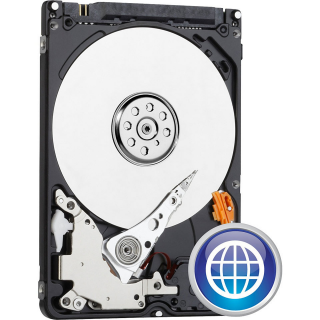

  • bu nasıl, WD Scorpio BLUE 2,5" 1TB Notebook (WD10JPVX) 166tl
    www.bizdehesapli.com
    http://www.bizdehesapli.com/WD10JPVX?ref=akakce&v=1.95.2
