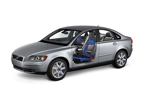

  • The Volvo Whiplash Protection System (WHIPS)
    Reducing long-term neck and spinal injuries by more than 50 percent
    Irvine, CA (June 30, 2003) - First introduced in 1999, Volvo's WHIPS is still being thrust into the spotlight. A new survey from Volvo's traffic accident research team shows that WHIPS reduces short-term injuries by 33 percent and long-term injuries by 54 percent. However, Volvo is not alone in drawing this conclusion. Several independent surveys reveal major reductions in whiplash injuries thanks to WHIPS.
    In Sweden, the Swedish Road Administration and Swedish Insurance Institute, Folksam, published findings of their survey and conclude that the number of whiplash incidents leading to serious injury would drop by 50 percent if all cars had the same system as that found in Volvo.
    Recent studies in the United States also support these findings. The Insurance Institute for Highway Safety (IIHS) compared seats in car models featuring the new head restraint with the seats fitted to previous model years. Volvo (with WHIPS) topped the average injury-reduction ratings with 49 percent. Volvo has been awarded the highest rating for headrest safety by the IIHS on every one of its models since 1995.
    Seven out of ten car accidents resulting in personal injuries involve whiplash injuries. The IIHS has discovered that "the key to reducing injury risk in rear-end crashes is to keep the head and torso moving together." They further add that to effectively protect occupants' necks, a head restraint must be high enough to catch the head and close enough to catch it early in a crash.
    As Volvo continues to lead the market in safety innovations, WHIPS has no doubt added to that success. WHIPS is offered standard on all Volvo vehicles.

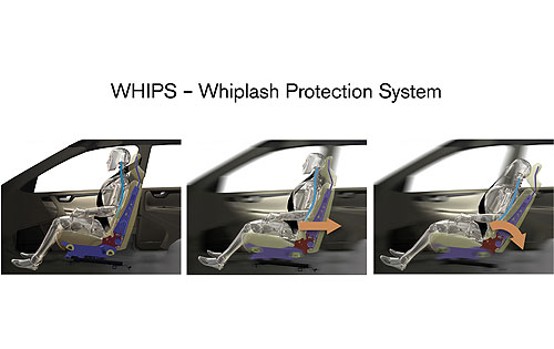

    A Note about WHIPS:
    The WHIPS seat provides improved spinal support by virtue of its modified backrest characteristics and close proximity of the head restraint's position to the occupant's head. WHIPS utilizes a specially designed hinge mount that attaches the back rest to the seat bottom, which has a pre-determined rate of rearward movement in the event of certain types of rear impacts. The seatback also has a series of springs that allows the cushion to move slightly rearward upon impact, thereby helping to cradle the body within the seat. This, combined with high-mounted head restraints, help to limit the "whipping" motion of the head that often occurs during a rear-end impact.

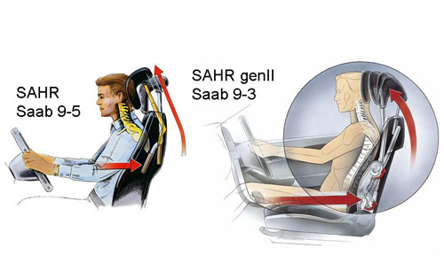

    Patenti Saab'a ait olan SAHR (Saab Active Head Restraint) sistemi ise ilk jenerasyonda aşağıda soldaki fotoda görüleceği gibi sadece başı koruyordu, sonra geliştirildi ve artık sırtı da koruyor.
