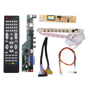

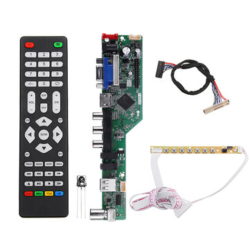

    yukarıda link ve resmini paylaştığım iki adet notebook lcd panelim var aşağıdaki iki üründe aynımı ? full set fiyatı daha uygun ama sanırım lvds sadece 2ch hangisini almalıyım bilgili arkadaşlar yazarsa memnun olurum.
    www.banggood.com
    T.V53.03 Universal LED TV Controller LCD Driver Board 1ch 6bit 30Pins Module Board from Electronic Components & Supplies on banggood.com
    https://www.banggood.com/T_V53_03-Universal-LED-TV-Controller-LCD-Driver-Board-1ch-6bit-30Pins-p-1401871.html
    www.banggood.com
    T.V53.03 Universal LCD LED TV Controller Driver Board TV/PC/VGA/HDMI/USB+7 Key Button+2ch 6bit 30pins LVDS Cable+1 Lamp Inverter Module Board from Electronic Components & Supplies on banggood.com
    https://www.banggood.com/T_V53_03-Universal-LCD-LED-TV-Controller-Driver-Board-TV-or-PC-or-VGA-or-HDMI-or-USB+7-Key-Button+2ch-6bit-30pins-LVDS-Cable+1-Lamp-Inverter-p-1401873.html
