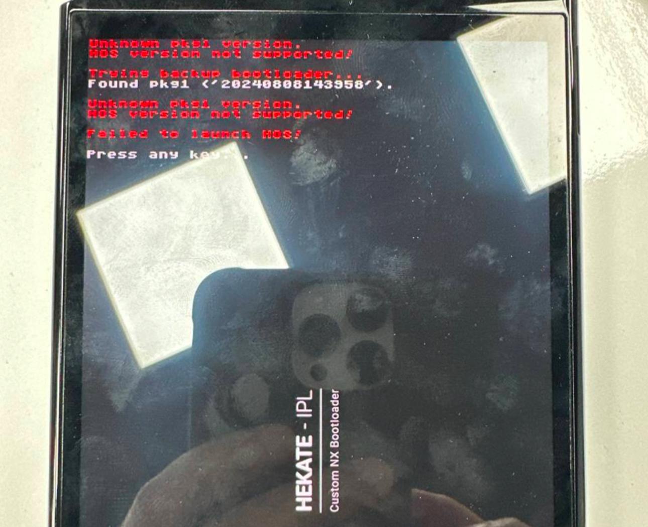

  • Beyler tam olarak sorun nedir sizce ve çözüm yolu varmı?
    Nintendo Switch CFW - Modchip - Homebrew - Ana Konu
    Düzeltme;
    aşağıdaki videodaki adımları yaptıım ve düzeldi.
    Nintendo Switch CFW - Modchip - Homebrew - Ana KonuJose's Shop and Servicesyoutube
    Hey! Thanks for using my tutorial, links here: HATS (location updates here): https://twitter.com/sthetixofficial hekate: https://github.com/CTCaer/hekate/releases Credits: CTCaer - for making hekate along with his highly skilled contributors and team members sthetix - for making and maintaining the HATS pack so well Music Daybreak - cxlt. (https://soundcloud.com/cxlt)
    https://www.youtube.com/watch?v=URplLUp7Bds
    < Bu mesaj bu kişi tarafından değiştirildi iskender86 -- 2 Ocak 2025; 14:21:41 >
