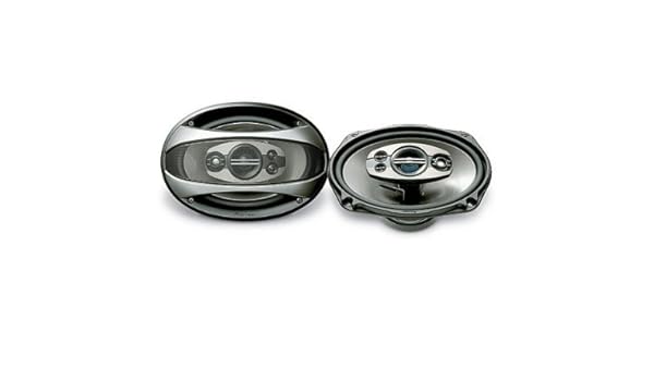

  • ARKADAŞLAR PİONEER 8350SD ÜNİTE ALDIM, ARKALARA 6993 PİONEER OVAL TAKTIM ÖN KAPIDA ORJİNAL HOP İLE TWİTWR VAR AMA PÖRTLEMEYE BAŞLADILAR YAKINDA PATLAR BÜYÜK İHTİMALLE.ELİMDE MASSİVE 16 CM SLİM MİD TAKIMI VAR, BUNLARI TAKSAM ANFİSİZ VERİM ALIRMIYIM YADA CROSOWER LI, CROSOWER SIZ KULLANMANIN FARKI OLUR MU? ÇÜNKÜ ANA ÜNÜTE NİN ÇIKIŞLARI ÇOK GÜÇLÜ 4V ÇIKIŞI VAR. ANFİ KULLANMAYACAĞIM İÇİN SUB DA YOK MİDLERİDE HPF KAPALI OLARAK KULLANACAĞIMDAN MİD İN BOBİNİNİ YAKARMIYIM ? NE DERSİNİZ ?.

    Pioneer TSA6993S 6-Inch x 9-Inch 5-Way Speaker (Pair) [Electronics]
    http://www.amazon.com/Pioneer-TSA6993S-6-Inch-Speaker-Electronics/dp/B0032UMY0E
