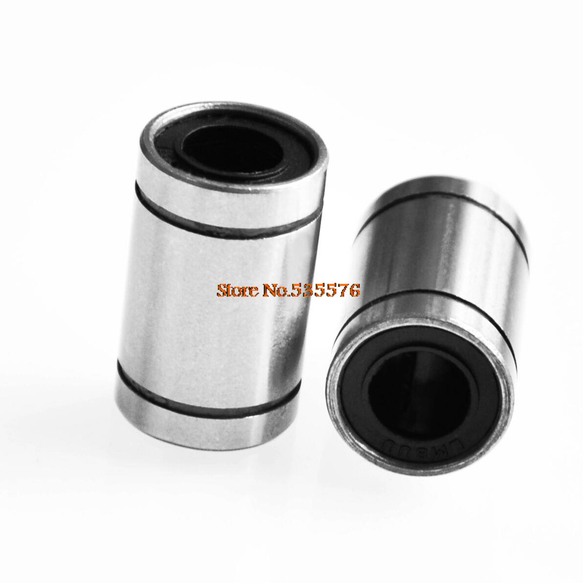

    Rulman Lm8uu;
    aliexpress.com
    US $4.9 |10pcs/lot LM8UU 8mm 8x15x24mm Linear Ball Bearing Bush Bushing 8mmx15mmx24mm for 3D printer|bearing bush|bearing productsbearings skateboard - AliExpress
    http://www.aliexpress.com/item/Free-Shipping-10pcs-lot-LM8UU-8mm-8x15x24mm-Linear-Ball-Bearing-Bush-Bushing-8mmx15mmx24mm/1789574218.html
    (hocam bundan 11 tane gerek ben 20 tane aldım)
