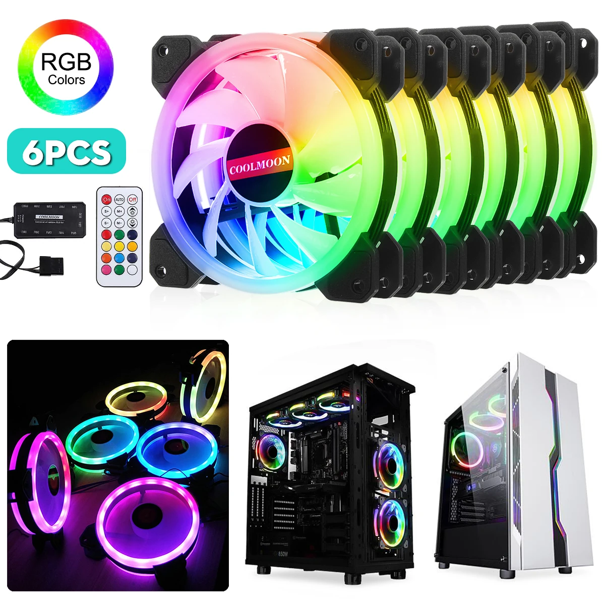

    6x KASA FANLARI
    aliexpress.com
    US $34.01 46% OFF|6pcs Computer Case PC Cooling Fan Cooler RGB Adjust LED 120mm Quiet + IR Remote New computer Cooler Cooling RGB Case Fan For CPU-in Fans & Cooling from Computer & Office on AliExpress - 11.11_Double 11_Singles' Day
    https://www.aliexpress.com/item/6pcs-Computer-Case-PC-Cooling-Fan-RGB-Adjust-LED-120mm-Quiet-IR-Remote-New-computer-Cooler/32839035135.html
