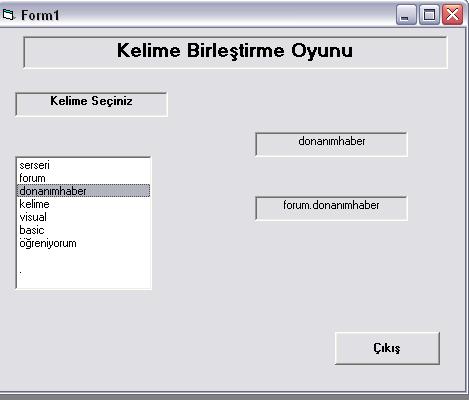

  •  Visual Basic Örnekler
    Private Sub Command1_Click()
    End
    End Sub
    Private Sub Form_Load()
    List1.AddItem "serseri"
    List1.AddItem "forum"
    List1.AddItem "donanımhaber"
    List1.AddItem "kelime"
    List1.AddItem "visual"
    List1.AddItem "basic"
    List1.AddItem "öğreniyorum"
    List1.AddItem " "
    List1.AddItem "."
    End Sub
    Private Sub List1_Click()
    Label3.Caption = List1.Text
    Label4.Caption = Label4.Caption & List1.Text
    End Sub
