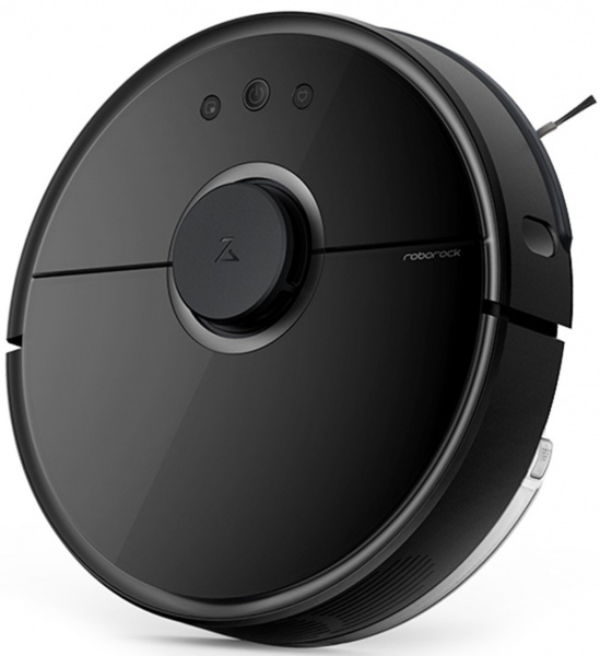

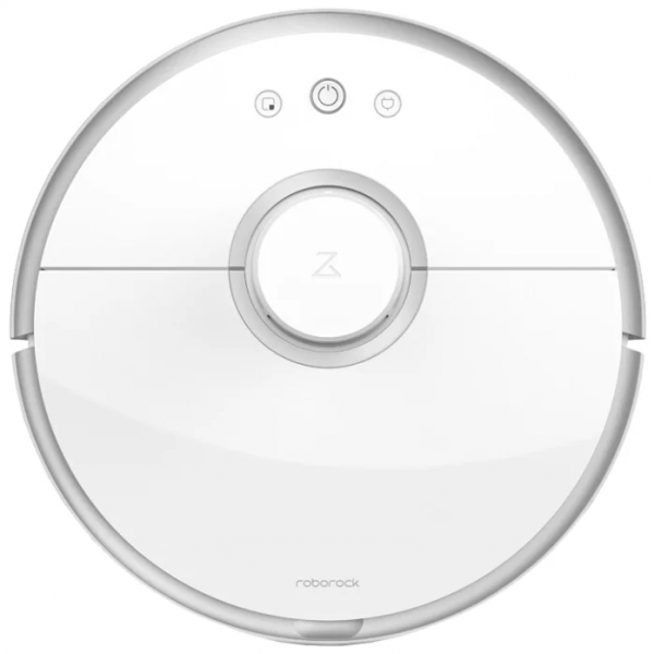

    Rusya da sitesinde 26580 rub.. yani 2300 Tl civarı. O zaman hedef belli oldu :)
    |77807383332|aid|358501487479|placement|&utm_term=&gclid=Cj0KCQjwpPHoBRC3ARIsALfx-_L5nzKSF88_7Q0d48xwXQ0-CvsezlQ8cupQ2kenyr-tYQTAdJka35EaAronEALw_wcB
    S55 de 26990 Ruble
    xi.express
    Робот-пылесос Xiaomi Mi Roborock Sweep One черный
    https://xi.express/catalog/robot_pylesos_xiaomi_mi_roborock_sweep_one_black.html

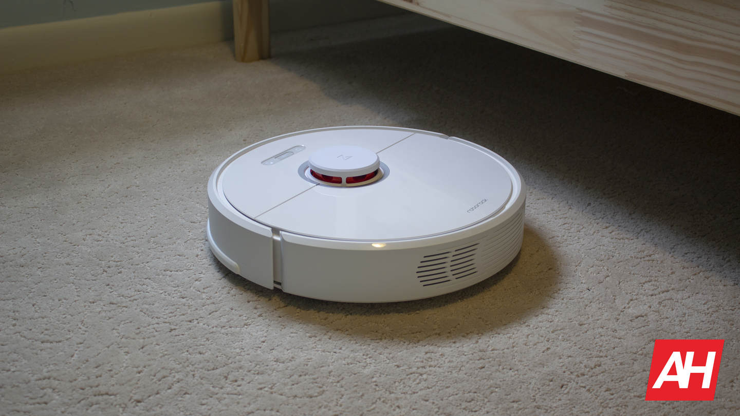

  • Xiaomi S6 sonunda Avrupa ve ABD’de satışta:
    Android Headlines
    Roborock S6 Now Officially For Sale In The US And Europe
    https://www.androidheadlines.com/2019/07/roborock-s6-for-sale-us-europe.html
