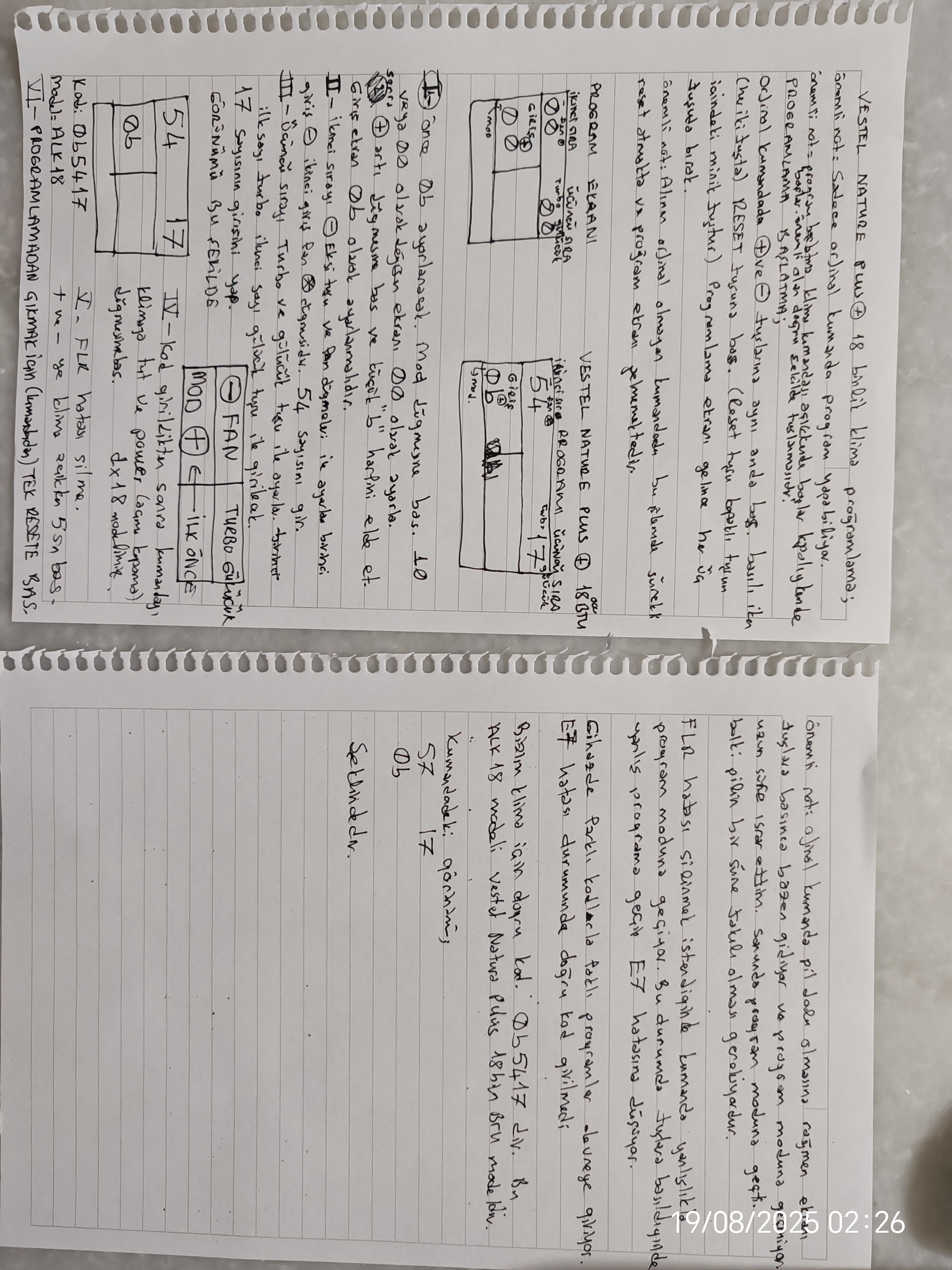

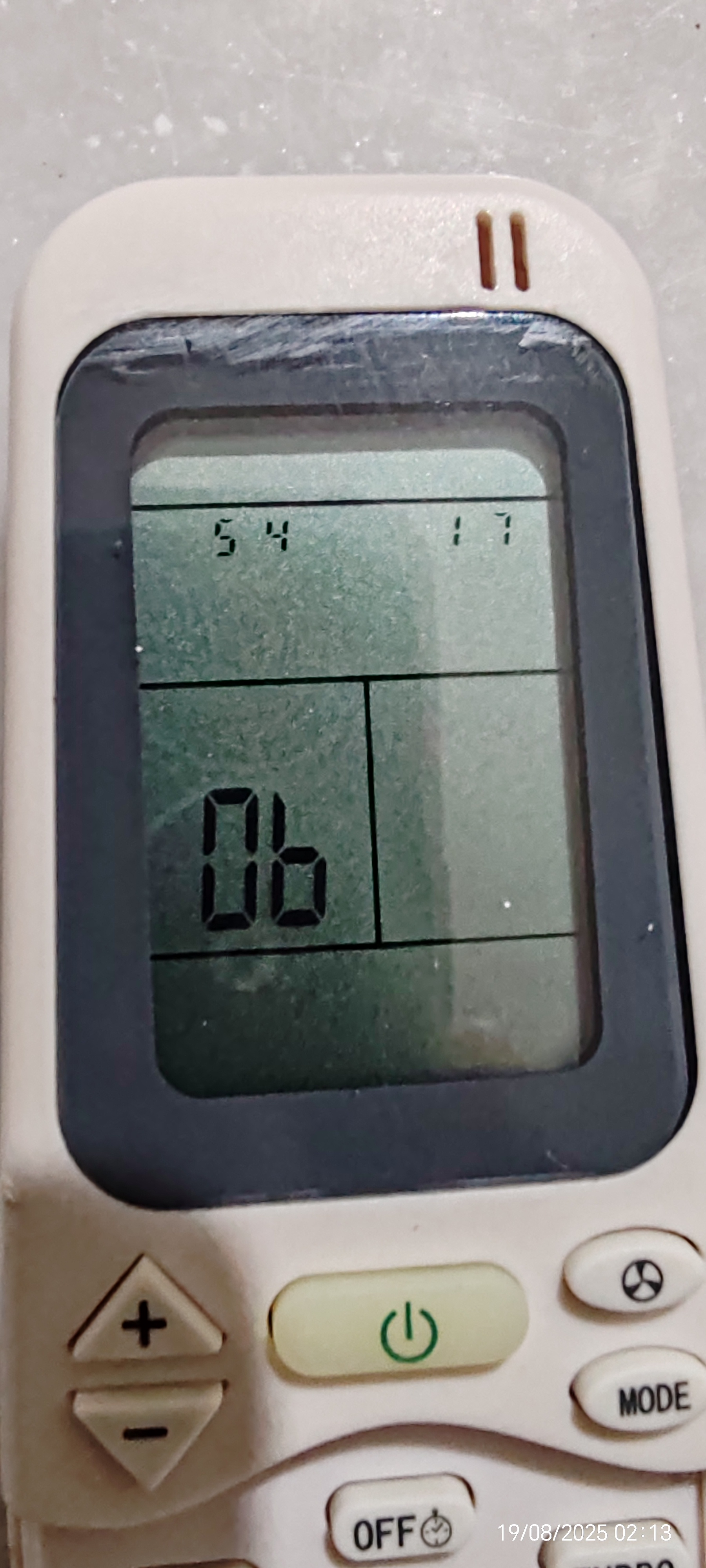

Vestel Nature Plus 18000 BTU KLİMA PROGRAMLAMA SORUNU
