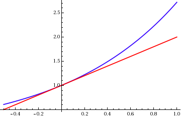

    The formulations that should be used can be found in the following references:
    en.wikipedia.org
    Approximation error - Wikipedia
    http://en.wikipedia.org/wiki/Approximation_error

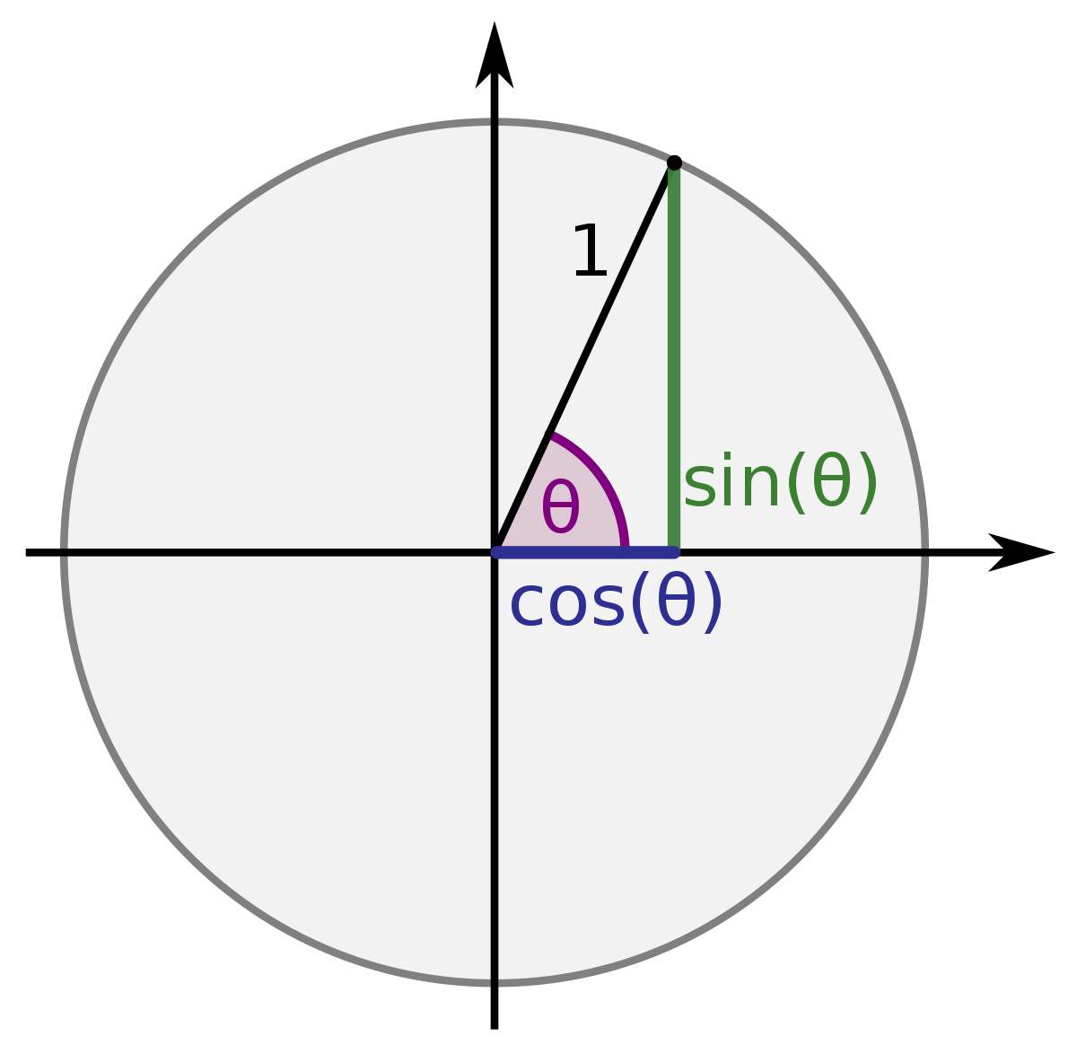

    en.wikipedia.org
    List of integrals of trigonometric functions - Wikipedia
    http://en.wikipedia.org/wiki/List_of_integrals_of_trigonometric_functions

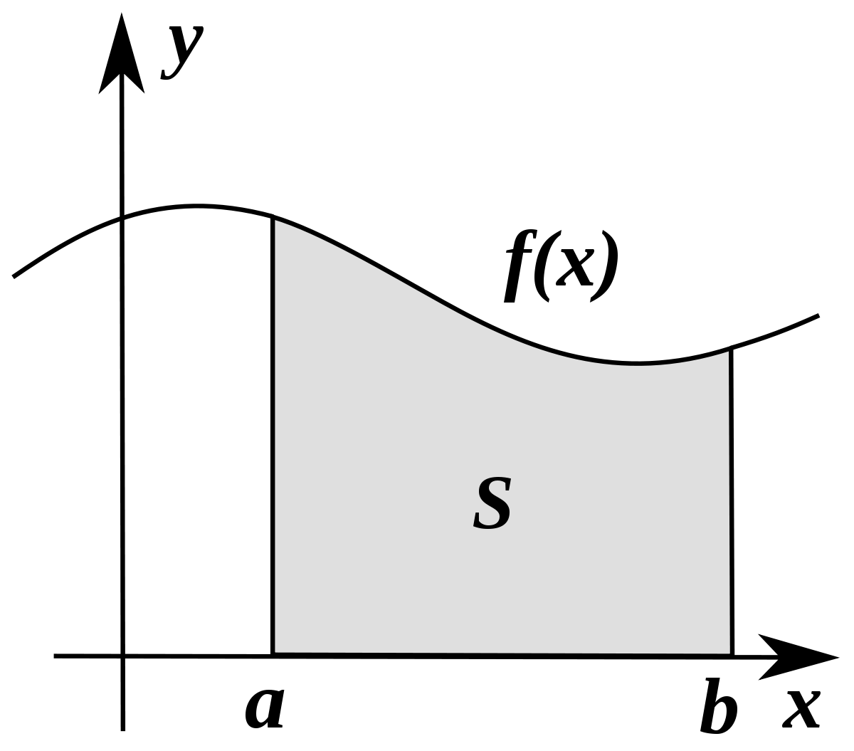

    en.wikipedia.org
    Numerical integration - Wikipedia
    http://en.wikipedia.org/wiki/Numerical_integration
